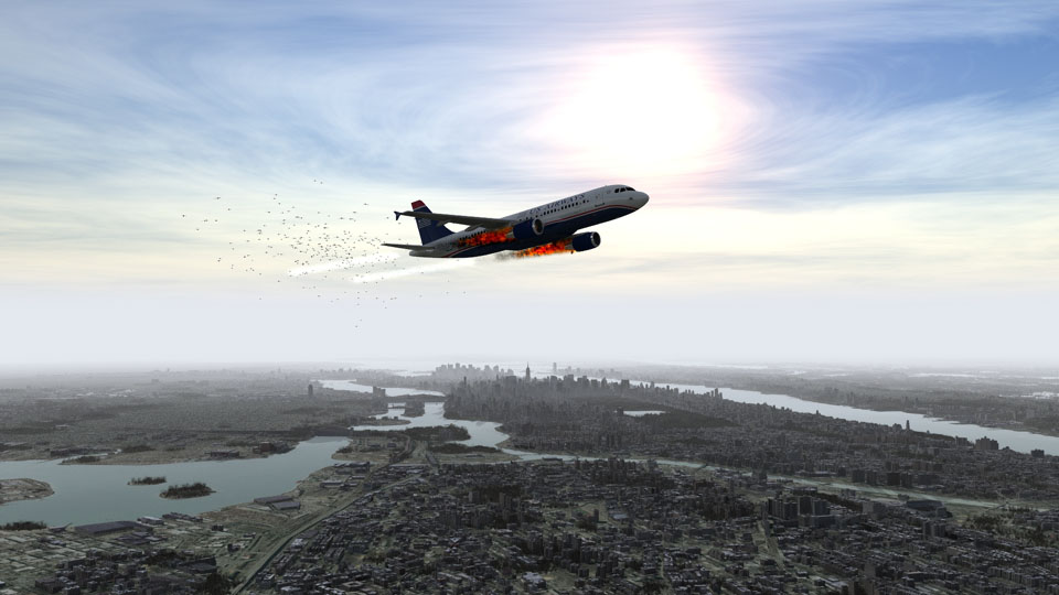

Flight 1549 Hudson River, 3D Reconstruction
while this is definitely not photo-real work, i wanted to share my lightwave project because it shows another application of the software: engineering-based animation. all rendering is done in LW9.6, compositing of layers in adobe premiere.

fire, smoke, splash

i used skytracer2 for the atmosphere, hypervoxel sprites for the fire and smoke effect (very quick render times compared to volume HVs!) and i utilize the built-in ground fog plugin to create a distance effect. i was using a 32bit image file for terrain displacement, but that was taking 30 seconds per frame to freeze the mesh, so i *baked* a polygonal terrain object and sacraficed some accuracy in exchange for speed. i used pawel olas' random cloner to create distributions for my vegetation, as well as some other tricks, but that is the only purchased plugin i used.

you can see the birds in the animation, at time ~2027:11. i made some very simplified objects of the appropriate size, but they are definitely not geese if you looked at them close. for all the work it took to figure out exactly where they were and at what time, they only flash across the screen for a few frames.

"It should be called "engine suck", the birds aren't striking.."
- Eddie Izzard
Couldn't resist
Nice work, great looks on the ground detail and sky too.
